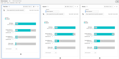

Originally, I tried creating a segment for each of the above steps, by Category. (About 30 different segments). That method didn't seem to work at all.
Currently, I'm using metrics (not segments) to define each step instead. Then I use a quick segment to build a fallout chart for each category. Metrics used:
  • Total Visitors
  • Product View (exists)
  • Cart Addition (exists)
  • Order (exists)
This method produces some more believable numbers, but I'm not sure it's exactly what I'm after in the main goal above. I feel maybe the first two steps are accurate, but cart addition would be considering products from ANY category, same for purchases. That's not what I'm after. I want to know fallout of visitors who viewed an Electronics product, carted an Electronics product, and purchased an Electronics product.
Is this possible?
-Brian
Current method results: 
Example definition of a Quick Segment used:
