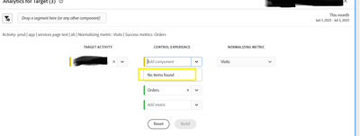

Hi Team,
We've created an AB test activity for the mobile app and we have selected a specfic report suit other than our web one. We've observed following issue when we click the "view in analytic" link in the Adobe target report section to check A4T report. This works fine on those activities which are created for the web. Is that we are missing anything on the app sepecfic report suit. How can I fix this?
Looking for any help.

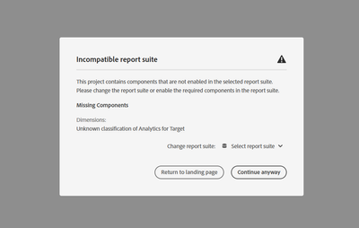

It looks like there are some classifications that are expected but missing from the report suite. Do your web & app activities use the same report suite? If not, look to see what classifications the web reports are using and verify those are in your mobile report suite as well.
That error usually means the report suite you’re using for the app doesn’t have all the required A4T components enabled, especially the classifications like activity name, experience, offer, etc.
You might want to double-check that the report suite selected for the mobile app is A4T-enabled. Just because it works for your web suite doesn’t mean the same setup exists for mobile, they need to be configured individually.
Also, it’s worth confirming whether the necessary classifications for A4T (like the "Analytics for Target" ones) have been provisioned for the mobile suite. If not, you’ll probably need to contact Adobe Client Care to get those enabled, that usually resolves the “incompatible report suite” error.
And if you’re using the AEP Mobile SDK, make sure the A4T configuration is properly set up within the mobile app implementation too.
Once the report suite has the right components, the A4T reports should work without that error.

Hi @Vinay_Chauhan , Thank you for you reply. I’ve reviewed the Analytics for Target (A4T) classifications, and they exist in both the mobile and web report suites. On the mobile report suite, these classifications are also working correctly in freeform tables. However, when I checked the A4T report, it showed “No Control Experience Found.”
For the web implementation, we are using AppMeasurement.js, whereas for mobile, we are using the AEP Mobile SDK. Could you please help us verify whether the A4T setup has been correctly implemented on the AEP Mobile SDK? It looks like that could be the issue.
