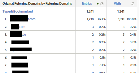

while investigating some wird referrer, I noticed that when I apply the 1st time visit segment to the Original referring domain report broken down by the Referring domain report and applying Entries metric, I can see that the numbers don't match. Shouldn't they match for the 1st time visits? Am I missing something?
Here's a screenshot:

Agreed! But if you look at my report, it says: Original Referring Domain "Typed/Bookmarked" and then broken down by entries, I get entries for various referring domain! Rather I'd expect tthe Entries to be 0 for the various referrers encountered during user journey.
But in my report I get 99% of the entries for one referrign domain! And the original referrer is direct. Something is wrong, right?
Segment definition: Visit contains "Visit number equals 1"
Report for 1 day
Level 6
After some testing I found out there is a specific pattern as to when it is wrongly attributed. Only in case the user is entering the site directly (without referrer) and returns within the visit via a referrer, then his entry will be attributed as follows:
Original referrer = direct 1 entry
Referring domain = google.com 1 entry
So something must be wrong, I don't know if in the implementation or the attribution.

Gigazelle​ Your answer does not take into account that we are talking about First Time Visits (Visit number = 1, Dimension: Visit).
Regarding the entries metric, original referring domain and referring domain should be equal for first time visits.
I found the solution: it lies in Adobe backend on how they process referrer information.
Since our implementation is done via GTM, it is characterized as "non-javascript" for Adobe. And if referrer value is blank and tracking call is non-javascript, then Adobe ignores this for the referrer report! And the confusion starts here: it does not do so for the original referring domain report!
If later on during the journey a referrer is passed, lets say google, then Adobe counts this as referrer and thus the entry is attributed to the first valid referrer instance, which in this case is google - no matter if is happened later on in the journey.
