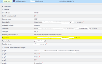

in client website, there is an pdf download link and they tracked in adobe analytics but without using any adobe event like event1, they tracked through custom links, i think, so what will be the impact and solution.
