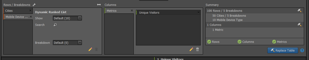

Every time I run a DMA report I am only ever to download 5 DMAs at a time. I have tried everything:  all file formats, zipping, sending directly to my email. Nothing works!  Can you help?
I should mention this DMA report includes a "Broken down by:  Device Type"
Best answer by pankajbagga_sme
Below steps may help you:
1.) Go to adhoc analysis (Launch Ad Hoc Analysis )
2.) Search for your report, break down by Device Type
3.) Expand Table Builder
4.) In Breakdowns column and show column, select the maximum levels keeping in mind 50,000 multiplication factor is a limit of breakdowns.
5.) Click on Replace Table. That's it, you are good to go then!
Belowscreen shot for reference.

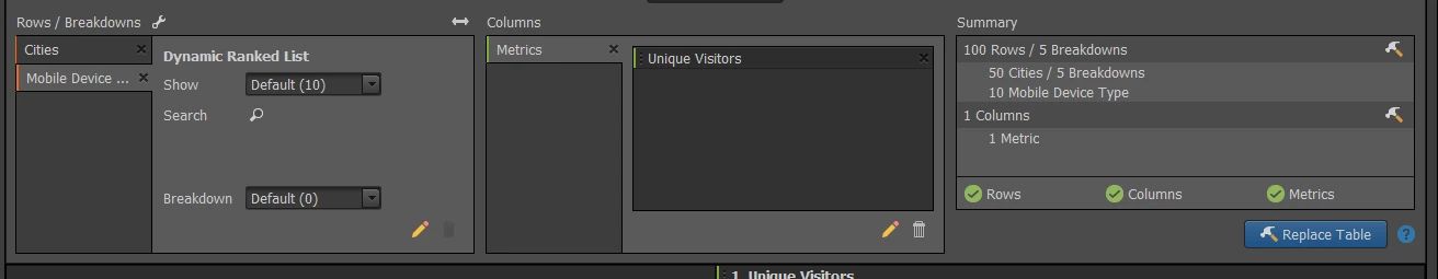

September 10, 2017
