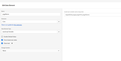

The Data Element

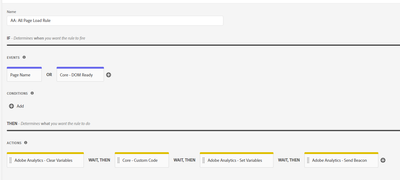

Here is the Page Load rule
isPageView is set to 1
and the Link Name & Link Type are blank.

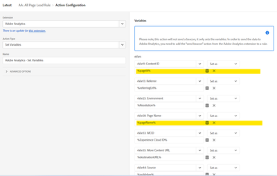

Here is the AEP rules
I am highlighting 2 examples Evar11 works, evar28 does not

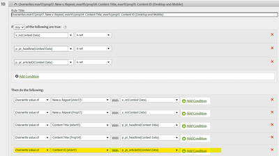

And here are the processing rules which were set up originally for our first site (that hasn't moved to AEP yet, but both sites are going to the same report suite)
Or is that the issue, that this rule could be overwritting the data when it shouldn't be.

Rule 28 looks like your culprit...
So Looking at the first Rule 10, likely none of those conditions are met, so the rule doesn't trigger.
But Rule 28, one of those conditions must be "passing", and I am sure that page.name is not being set any longer, which means it's an empty value... and that empty value is overriding the value you are sending from Launch...
You should really review ALL the Processing Rules... if they aren't needed you should remove them all so that other parts of your tracking isn't impacted. Just because Rule 10 isn't triggering now.. doesn't mean that there is some scenario where it might trigger... Keeping your Processing Rules clean and only keeping rules that are needed there is going to be much better for your implementation.. and IF you need to use Processing Rules in the future, the person who adds new rules will only have to deal with active content, and not historical leftovers which are now essentially garbage....

BUT, when looking into that rule (it was actually another rule, the rule I screenshotted was for our App), there was a condition of
So it will be the global Page URL variable, which means it was then updateing our eVar28 with blank data.
