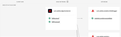

Can you check the Edge > Event Transactions?
This should give you a visual breakdown of the flow of traffic... mine looks something like:
Compare Android and iOS... I suspect a lot of this will be missing...
