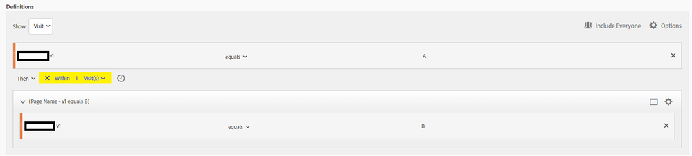

I'm having some problems in getting results with a segment that should give me the visits whenever a visit sends an eVarX with a specific value (let s say A) in one page, then another value on the next page (lets say B) :
A->...->B
For this I use a 2 visit container segment with a "Then" in between.
Although this seems correct, I only get 0 values on Page views, visits and Unique visitors.
Could someaone explain if there are limitations to the "Then" segments ?
Thaks again for the help!
Cheers to the adobe community!
M.

  Try the attached segment snippet as a reference for your question -
Saurabh Kumar.
Level 8
Great !
Works better ! Now I have some results on my segment, thank you very much Kumar !
