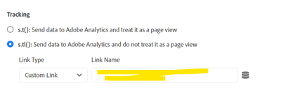

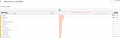

Adobe "click" actions have a default parameter called Link Name (it will show up in Workspace as "Custom Link")
In your app, your trackActions also pass a value that will populate this field (though it should be noted that the app will append "AMACTION:" to the beginning of the custom link value (there is nothing you can do to prevent this 😞 )
The Occurrences metric will trigger on all page views and actions automatically.. so if you have Custom Link set, you should be able to see it like your App table already, just use "Custom Link" as your breakdown and Occurrences as the metric (assuming of course that you set unique values for your Custom Links when you did your tracking)
However, if you have set up a custom eVar or Prop called "Action Name" you should be able to set this value in Adobe Launch on your clicks, or map it in with processing rules (it really comes down to personal preference).
You can set up any props, eVars, events, etc etc that you want on your button clicks/actions. Just like page views, you can populate any correlation values that you need to give your action insights.
You can use both solutions if you choose.. a custom event for each button, and the occurrences (just like you have for your app) there are many ways to accomplish this... but it's hard to rally give direct advice without seeing your implementation, but hopefully these tips help, and if you need more advice, please let me know.

I did set up the click in the tracking as you showed in the picture and set up it button click as an event.. will also try as eVar.
