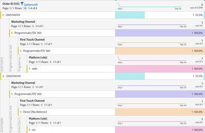

  1. First Touch Channel Breakdown Issue
  • Currently, when breaking down First Touch under the programmatic channel, the data is split across Direct, Programmatic, Paid, Facebook, and Others.
  • Ideally, it should reflect only Programmatic, since users are directly landing on the app by clicking an advertisement.
  • A direct visit should only count when users open the app on their own or visit the site by typing marksandspencer.in directly, not when they come via ads.
  • I’ve attached a screenshot for more clarity.

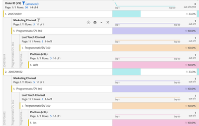

    2. Last Touch Channel Breakdown Issue
    • When breaking down Last Touch for the programmatic channel, only Programmatic appears, while MoEngage should also reflect here.
    • This is because if a user comes from programmatic, they often end up converting via in-app notifications, which means MoEngage should show up as the last-touch channel.

First thing to say is- Marketing Channel report is Last Touch. In that second screenshot what you are doing is breaking down Last Touch channel by Last Touch channel, so of course it's exact same. In the first screenshot, it's saying that when the Last Touch channel was Programmatic, what was the First Touch? Maybe a read through here will help:

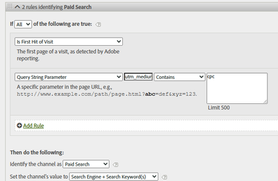

Second, it's very difficult to know what issues you have just from the reports- we'd really need to see the Channel processing rules. You mention in-app, is it a mobile App specifically? If you have Lifecycle metrics set via Mobile SDK, then the first hit will almost always be a lifecycle hit (which generally won't have any channel information). As such, if your channels are all set with 'is first hit of visit' ticked, then straight away this will cause issues.

During testing I noticed that when I start a session and place an order through this Appsflyer deep link, the visit is being tracked as "Direct" in Adobe Analytics under the First Touch Channel. This likely means the UTM parameters aren’t being picked up correctly either they're getting lost during the redirect or not passed through properly to Adobe.

Is your paid channel set to detect '1st hits of visit' as I mentioned?
If so, I highly doubt the first hit has the utm information as it's usually a lifcycle hit. You might need to change that to remove 'is first hit', & possibly do that for all rules. You may need to re-think how your channels are setup based on this.
