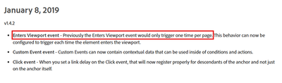

From this release note, it seems like enter viewport would only trigger once time per page, but I am just wondering if someone has a way to retrigger the rule when I go back to CTA 1?
