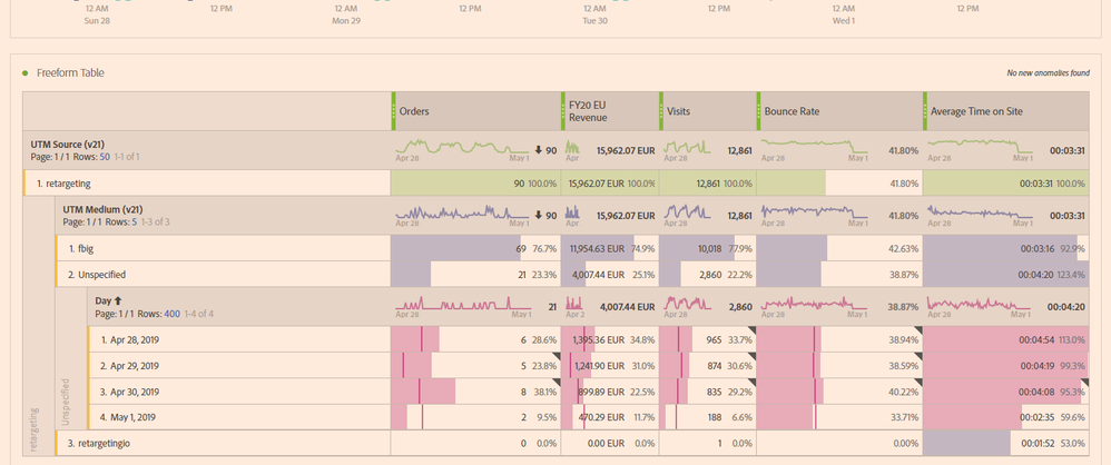

I'm new to adobe analytics, and started playing with the attribution windows.
I'm finding that some of the visits and revenue columns are changing after a couple of days.
this was the data on the first of May.
the same data had changed when I looked the next day.
When I look at the details for this certain parameter, we see some items get put in the wrong category, but after three days this would get corrected.
One of the analytics users checked, and there wasn't any changes in the administrator levels to this certain table that we are using.
From what I understand, attribution should correct it self after 24 hours, not 3 days.
What might be causing this delay, or the conversion numbers getting changed?

Dear Richard,
Form the table, I can understand that the dimensions you have selected were Classifications.
Verify whether you have updated any Classification Rules or whether you have added the current date(Today) to the report. Usually classification takes 24 hours to classify so, at some case they qualify under Unspecified and later under proper classification value.
Thank You!
Arun
Hello Arun.
Thanks for the clarification.

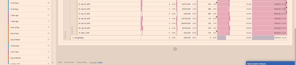

When I pulled the report, I did have the current date in the report. However, I was seeing changes on data from the 28th of April, when I pulled the data on May 1.
We are seeing data that was qualified under "Unspecified" are changing when we pull data from 3 days ago. From your comment, shouldn't this only be 24 hours instead of 3 days? I am seeing data from the 4th of May change when I pull this data today (7th of May) every time I refresh the data
