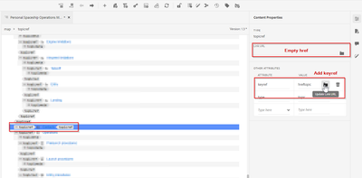

@sschnelbach :
As I checked currently you have to do following:
- Add a topic ref pointing to any topic
- Then in editor, you have to remove the href, and then from properties panel you have to select an attribute "keyref" where you get the browse option which will open the dialog to choose the key
The above steps would achieve what you want - but these steps can be avoided by providing an option directly on "Insert Topicref" dialog to be able to add keyref instead of just href.
I hope this is what you are looking for. Once you confirm we can log a change request for same.

Level 6
Yes, a menu option to add the key to the map would be nice. In XMetaL, when editing the map, you select a topic, click Properties within the map editor, and you can add the Key in a field. If you can have a similar option within the map editor for Guides, that would be great.
It looks like most of the menu options when editing a map remain the same as when editing a topic, which implies these options will work when they do not.
Acknowledged.
I have raised a change request and engineering will pick this up soon.
