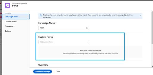

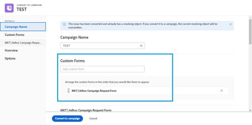

Today I noticed that when I create an issue with one of the queue topics and I convert it to a project, the Custom Form is automatically added to the Project:
However, when I use other Queue Topics, they don't automatically include the custom Form:

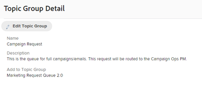

I think there's a clear issue with the setup, but when I compare them, they all look the same. I've compared the Queue topics and the Topic Groups, and they all look the same.

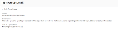

Here's a capture of the Topic Group that works as expected:
This is a capture of the Topic Group that isn't attaching the custom form automatically:

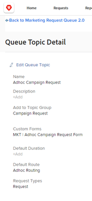

This is a capture of the Queue topic that works as expected:

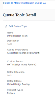

This is a capture of one of the Queue Topic that isn't attaching the custom form automatically:

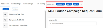

I think I actually found the solution. There was a problem with the setup, but it had to do with the Custom Form, not with the queue itself.
So when you start a new Custom Form, you have to select what type of object is the custom form for. The one that was automatically transferring into the project upon conversion is set up as "Campaign (our word for Project)" and "Issue". The one that wasn't transferring only had "Issue" selected as Object Type. When I added "Campaign/Project" to that selection, the form started automatically transferring into the campaign when I convert the issue.
