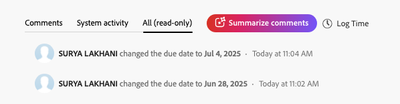

You can start by adding the Planned Completion date to the Update Feed. While this will not track the change, as you have mentioned, it will at least note when it was changed to a certain date. This would also record when PCD was changed due to a change in Duration.
