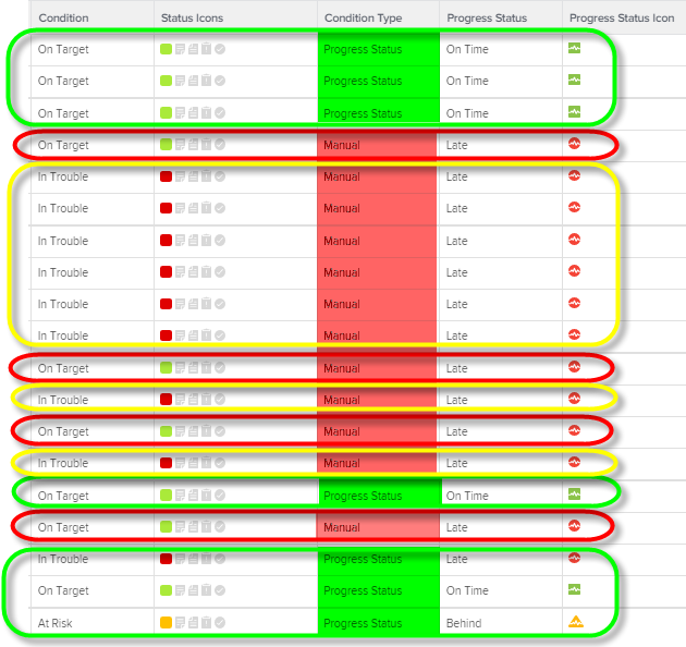

"This is an important edge case (and a very juicy topic), which has to do with Project Condition and Condition Type at the Project level."
"Depending on the Condition Type (Manual or Progress Schedule), the Project Condition (shown at the top right of a Project header) might not be the same as the Project Progress Status (which is automatic). As below (from an anonymous client environment…nothing like Real Data to tell the story…), when 'Manual' is set, it creates (in my opinion) a ticking time bomb (yellow) where the Condition on the Project happens to match the Progress Status at the moment, but could easily and without noticing falsely report (red) a Condition that is different from the Progress Schedule (commonly referred to in the business by some as 'BS')."
"With the intention of avoiding such situations (and in fact highlighting them), our Project Status Report (currently) uses the automatic Progress Status to drive the Schedule KPI (green)."

"PMs quickly observe that if they set a Project's Condition Type to Progress Status, their Projects appear as At Risk or Late almost immediately, even without tasks. That behavior causes confusion for the PM, is deflating, inaccurate, and leads to ignore and/or distrust the Project Condition. The amount of detailed task level work required to keep the Project Status on track (especially when the PM 'knows' it is on track) is simply not worth the effort. Instead, PMs can simply switch the Condition Type to Manual, and periodically review and adjust the Condition as and when they see fit."

For my previous company, we had too many people abusing the On Target manual approach so I actually had an API call go every night to change it to Automatic. A lot of the excuses we were given is that the project is on hold pending the client, and so we told them to put the project in an On Hold status. The excuse was that the project was a request queue and so we have a special status called Request Queue so that it isn't included in any of our behind/late reporting.
Now with that said, we do tend to ignore At Risk progress status as that seems a little trigger happy to us. But by the time it gets to Behind, it is important something is updated/corrected.
