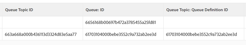

We're likely going to be doing some processing in Fusion of the requests in our queue, so I started looking at ways to differentiate the requests from the delay issues (or from additional requests/issues handled by other units in our company).  I created an issue report of two test issues--a task delay issue and a request:
For the delay issue, there's obviously no Queue Topic; however, there is a Queue ID.  I can use the Queue Definition ID as a filter in a Watch Events module, but now I'm curious--what exactly is the Queue ID in a non-request issue, and what function does it serve?

to me Queue ID and Queue Definition ID are the same thing. this is clearly visible when you switch to text mode for queue ID field
I guess this shows as blank in line with topic ID missing in a given situation, and because that 2nd ID is being pulled via queue topic.
But to answer your question specifically, request/issue is always raised somewhere, on a project, on a task, so there is always some unique identifier for that location simply.
