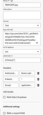

Currently, we have to do a manual refresh of the token used for authentication. There is no direct way to automatically update the token within the system. Therefore, each time the token needs to be refreshed, it must be manually updated in the Headers field.
This is for the field type, External Lookup, and currently our token refreshes about every 20 minutes due to security but also results in errors.
Is there a way to avoid this and have this somehow set up using Adobe Fusion?

any luck on a solution for this?
I've heard of combining Fusion with External lookup field but no luck
Hey @UWHa2 ,
Unfortunately, not yet. There might be a way to update the headers in Workfront's external dropdown via Fusion, but it seems to be a cumbersome process. You could try using your API key, though it's generally not recommended as a best practice, it does work.
