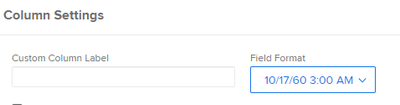

Hi there! Date fields in a report can show just date, or date + time. Go into the date column of your report > advanced options > there are field formats you can choose from. Is this what you're looking for?
@Madalyn_Destafney Hi! ideally yes that would work, but this is a project report with task level data, so to get the task level data i need to use text mode to pull in the information. i assume that "{plannedCompletionDate}" has date/time in it, but i don't know how to display it as date and time, just date at the moment.
@flieckster  try replacing the valueformat in your text mode with this.
valueformat=longAtDate
To find this, I took a project report, added the date format that Madalyn mentioned to a date field, then flipped that to text mode too see the valueformat
hey @Heather_Kulbacki thanks for writing back! i tried that actually, and it works great if i'm just calling the date, but in my value expression i'm calling for other fields, so it doesn't seem to work. is there a way to have multiple value expressions so i'm just formatting the date and not any other fields?
