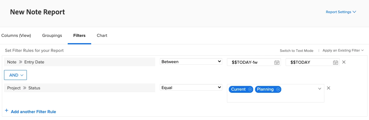

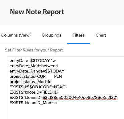

Hi Ross - I would recommend doing the out-of-the-box "wizard" for the filters that you want first for the object (in this case a note), and then when you are done, you can just switch to text mode and paste in the EXISTS filter you need.
Step 1:
Step 2:
Hope that helps 🙂

For the filter, you will want
EXISTS:1:$$OBJCODE=NTAG
EXISTS:1:noteID=FIELD:ID
EXISTS:1:teamID=c018bbf3df9245cae053a7656a0a9384
EXISTS:1:teamID_Mod=in
opTask:projectID=608c51210002053774d30099904b543f
opTask:projectID_Mod=in
opTask:statusEquatesWith=CLS
opTask:statusEquatesWith_Mod=notin
What this does...
-- The EXIST filter is connecting the NOTE object type to the NOTE TAG object types (it is a collection) and then says if any of the tags are for a specific team (just change the ID)
-- The opTask:projectID is if you want it tied to a specific project (which I think you are looking at this for the Help Desk Queue, so just change out the ID)
-- status Equates With looks for closed and cancelled statuses and does not include them.
I hope this helps you.
