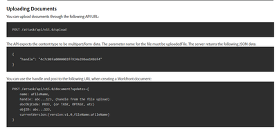

Unless that's a proxy onto the standard Workfront /upload REST API call:

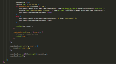

Then create the document in Workfront using the bulkimportproof:
Note that in the above we've already got a session ID from Workfront via the OAuth2 approach, and the project has already been picked via a simple UI that we built in our application.
Also note that we had to do multiple retries on the CreateDocument, as Workfront fails silently fairly often. It returns an object with a property called "data" where the value is a Document Object ID, but maybe 10-20% of the time it didn't actually create it. So we immediately go back to check if it's actually there.
