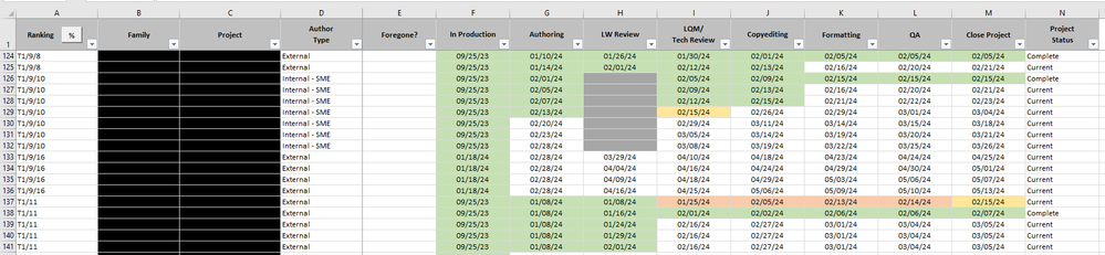

Level 8
Yeah, I find both the matrix reporting and the built-in milestone view underwhelming.  We rely on milestone reporting to give us an at-a-glance view on how different project populations are tracking.
Until WF can provide a better built-in solution, we've been exporting the raw WF milestone task data and using an MS Access tool to automate producing/formatting a crosstab query-based report in Excel.

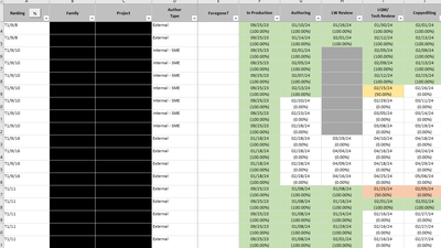

Level 8
Correct.  Currently we have 4 Access queries for each report.
The first query just includes project-based fields that can be aggregated:
The second query includes the task-based fields that will form the heart of the crosstab; in it I created a custom field that includes both the task due date and completion percentage (on separate lines):
I then used this second query as the source for the actual crosstab query; I specified the milestone column headings in the order I want them to appear:
Finally I created a fourth query that joins the first query (with the grouped project info) and the crosstab query; the queries are joined using the project name:
This last query is the one I export back to Excel.  The conditional formatting in the report is based off of the date and completion percentage (milestones that are 100% complete are green; ones that are less than 100% and are due today are yellow; ones that are less than 100% and were due in the past are red; incomplete future tasks have no formatting; if a milestone/cell is blank, it's gray).  I usually have the row widths set to only show the dates, but if I expand the row width, the percentage is also visible.
I've got coding in the Access tool that handles the import, export, and formatting of the Excel report.  Ideally I'd love to be able to do all this in WF, but this has been working for us in the interim.  Hopefully it will give you some ideas.
