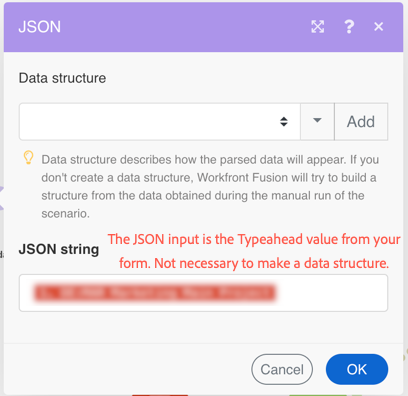

@TravisGrogan1 you need to add a "Parse JSON" module to transform the Typeahead value into its various components (ID, name, and object type).

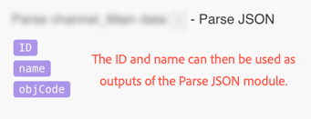

Then, you can use the output of the Parse JSON module to get just the ID or just the name.
Parse the typeahead:
Then use the output:
