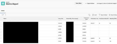

Thanks, Kellie. I did have everything in lowercase and it was still not working. So, I just added a calculated field in the custom form itself and then added that in the report. I wanted to avoid taking the extra step if there was a way to directly calculate the difference in the report.
can you screenshot your field in the report and then your calculated field for me to look at?
Not sure why the report shows the values today (it did not yesterday). But the weekday difference field is showing the value as the calculated field (Predication date diff - that I added to the form yesterday) shows.

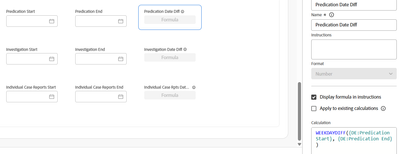

This is the form attached to each project with the calculated fields.
Thanks. From your screenshots, I can't tell what the text mode is for the calculated column in your report. But based on what I see for your calculated field, you created, this formula should work in reporting text mode:
valueexpression=WEEKDAYDIFF({DE:Predication End}, {DE:Predication Start})
The only thing I can think of is that in your original post, you had the V capitalized, and it should be lowercase. Plus, you need the spaces in the field names.
