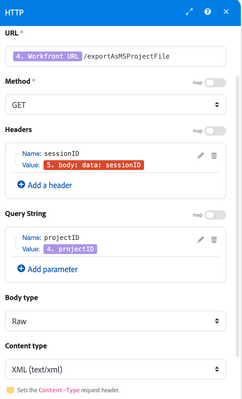

Hi @Tracy_Parmeter
Turns out it's quite simple: In Fusion
  1. get the Workfront session
  2. download the XML
  3. save (or upload) the XML file
Here's how it works:
The "Export MS Project" action calls the endpoint /exportMSProject and passes the projectID.
The response is the XML file.
JSON attached.
CC: @lgaertner @Kurt_Jones

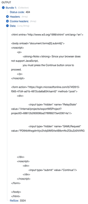

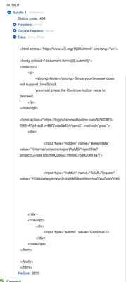

Hey @Sven-iX ,
I imported your XML and for me it runs successfully...kind of. I get a 404 status code, but it produces a file. The file, however, says this:
"Note: Since your browser does not support JavaScript, you must press the Continue button once to proceed."
Any ideas what I've got wrong?
Can't tell without more context/screenshots...
Here's more detail. LMK if you need more.
I tried both "exportMSProject" and "exportAsMSFile" (as spec'd in the Unsupported API actions for PROJ.
The outputs were the same.
exportAsMSProjectFile
