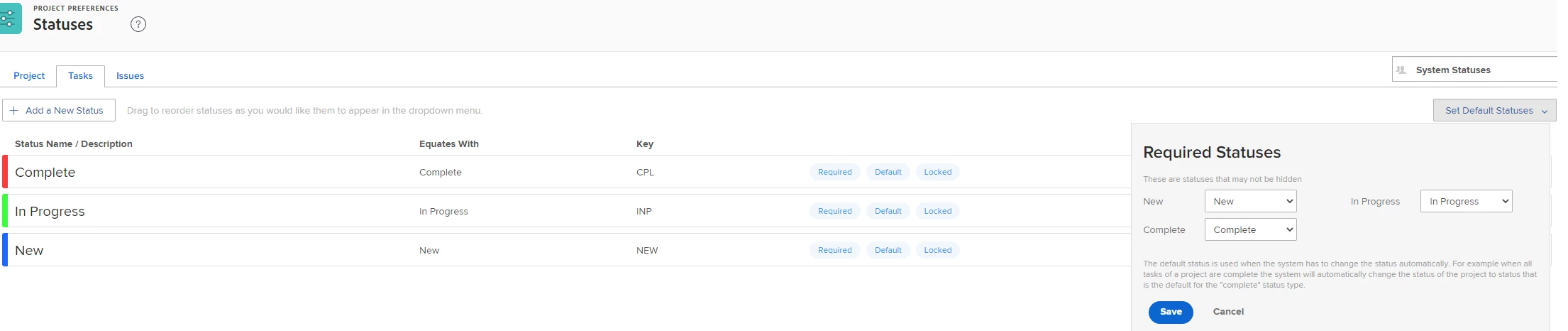

Ultimately CANCEL status will equate with something, most reasonable is COMPLETE. We have set it up like this:

Have you noticed that when you cancel all child tasks, the parent task automatically becomes "Complete" not cancelled?
Rafal_Bainie
January 19, 2023
I can see this being "per design", but worth checking with the support
