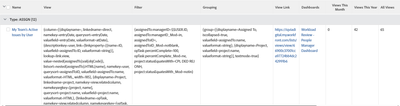

Here's how I do it in our instance. Sadly none of this is particularly pretty or human-readable, but is does expose the information you're trying to assess. What I show below is for an actual report, but you can add the same columns to a view to use in Setup as well, I've got the same set-up in the View/Group/Filter area under the Interface area too.
Report-Report - Screenshot below. Those three columns display the entirety of the text-mode behind that function on each report. Once you run the report, you can use the simple filter right on the report to put in the name of the field you're trying to locate.
displayname=View
valuefield=view:definition
valueformat=HTML
displayname=Filter
valuefield=filter:definition
valueformat=HTML
displayname=Grouping
valuefield=groupBy:definition
valueformat=HTML
Pretty it isn't, but it's saved me from breaking things quite a few times too.
