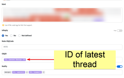

Currently, I am running a scenario that finds the latest update/Note on a project and posts a reply to that Note.
Only when I test this, it takes over 20 minutes to process this module. If I change the ObjCode to PROJ and use the ProjectID it works fine, it's when I switch it to NOTE and point it towards the specific thread that I am getting a very long processing time.
Any ideas?
