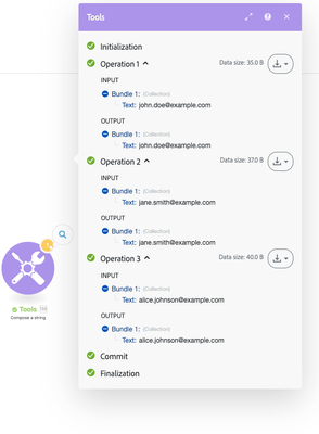

Question - If I only wanted to read the email column in the next module, how do I do that?
So it turns out that it was the approach, after all, and the iterator module. I don't think the Adobe rep can actually say that 😄  but the solution presented does not even use an iterator but instead focuses on creating a repeater using the HTTP DATA module output only - not that far from what you suggested but with a slightly different approach.
- get the data
- use the number of rows value from data to set a repeater
- compose a string to use in another string - depth
- compose a string within a get ( ) data function, like what you had suggested to get the value
repeater config
first compose string
final compose string (ignore the double quotes and "+" symbols)
actual configuration looks like this:
results
