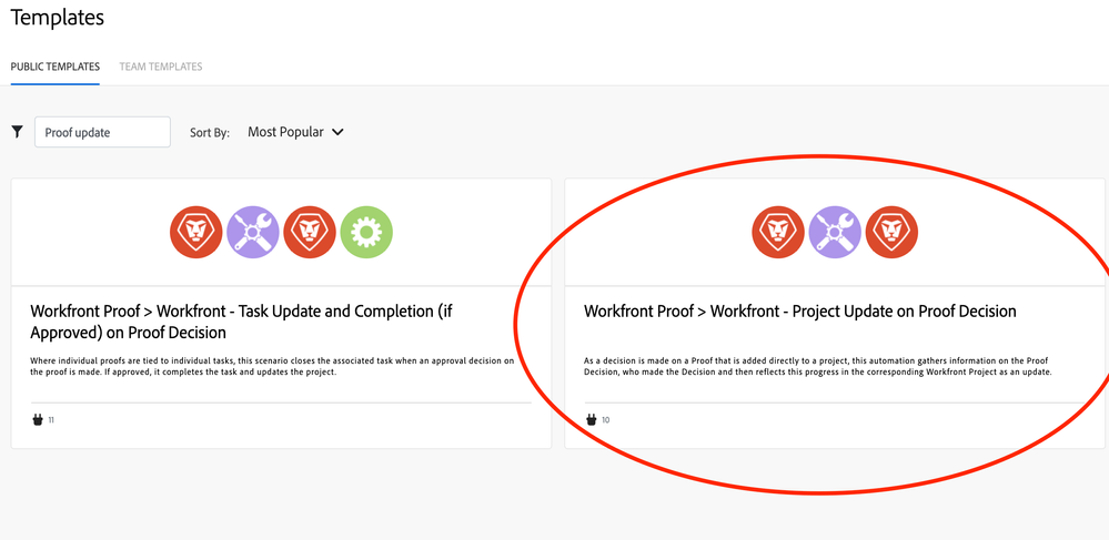

This is the template that I'm trying to setup @_Manish_Singh
Wonder if something is wrong with it because I didn't change anything when I put it together.
