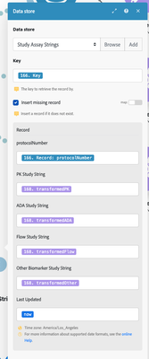

I had meant to also share the screenshot of the truncating logic downstream of the Data Store Search module, which runs "for each" search result:
This is the route in its entirety:
This is the last module used to overwrite the type-specific string:

Remove that and the rest looks good to me. You may want to uncheck "insert missing record" though.
Since it's 4 specific fields you could reduce the set you operate on by adding filters:
