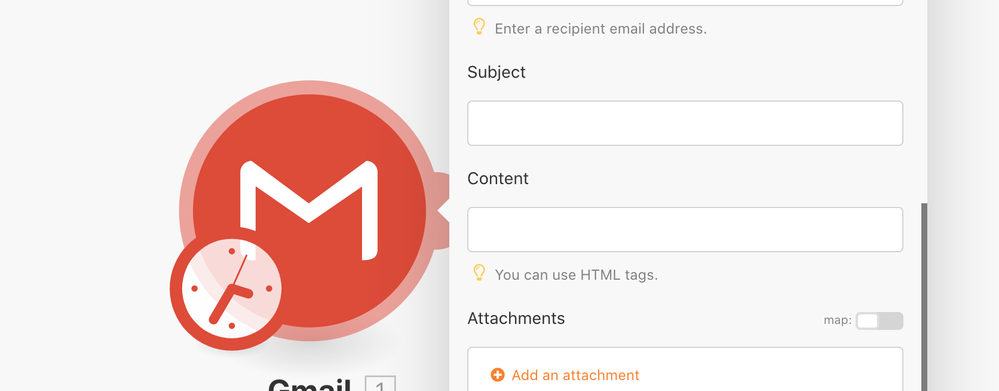

Gmail?
yep, you'll see the help text there just says you can include html tags in the content.
