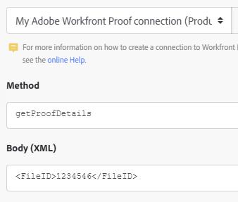

You'll need to use Fusion's "customAPICall" module for Proof.  Warning - it's tedious and likely will need some trial & error.
In "method" you paste in what the SOAP method is called (but not the parentheses)
See API documentation here https://api.proofhq.com/home/proofs/addcomment.html
The "SessionID" is implicitly sent if you use Fusion Proof modules.
Also: You don't have to emulate the full SOAP envelope, just the required elements. That means you're "payload" is not valid XMLe.g. you enter <FileID>123456</FileID> into the module.
The module will then add the pieces to make this a valid SOAP call.
Give it a shot with something simple first (e.g. getting proof details)
