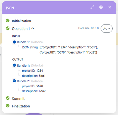

@viovi, have you tried enabling the "JSON pass-through" option for your webhook in the 2nd scenario?
With this setting the output of the webhook module will be a string, same as the payload sent to the webhook. Then you can do with that what you want, e.g. parse it as JSON.
Does this help?
Thank you, I think that was my issue with json formatting not passing properly.

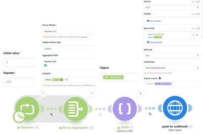

Here's a forced example: I use a repeater to create 100 bundles, and in the aggregator I group them by 20s.

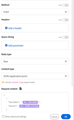

Convert the batch to JSON, and send it to the webhook
since we send the array as a named object the webhook receives a property "batch" that is an array.
Thank you, I ended up with the similar setup, just did not realize that I can pass batchNo in the heading.
