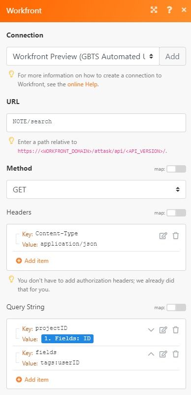

I'm trying to figure out how to automate notifications to all users who have been tagged in an update thread at any point. I know the NTAG endpoint is a thing but I keep getting this error when trying to call it through a Fusion API module:
The operation failed with an error. [422] APIModel V11_0 does not support field NTAG (Note)
Any help would be appreciated.

You can find out who is tagged in a note using the "Read a record" card for note
That seems like a good start...Does that pull everyone who has been tagged in all notes on a given issue/task/project? I assume no, but thought I'd check.
in that case you'll probably want to use a custom api module and search for notes where the project ID is equal to your selected project;0694X00000CIe9aQAD.jpg
Thanks @Ciaran Campbell‚!
