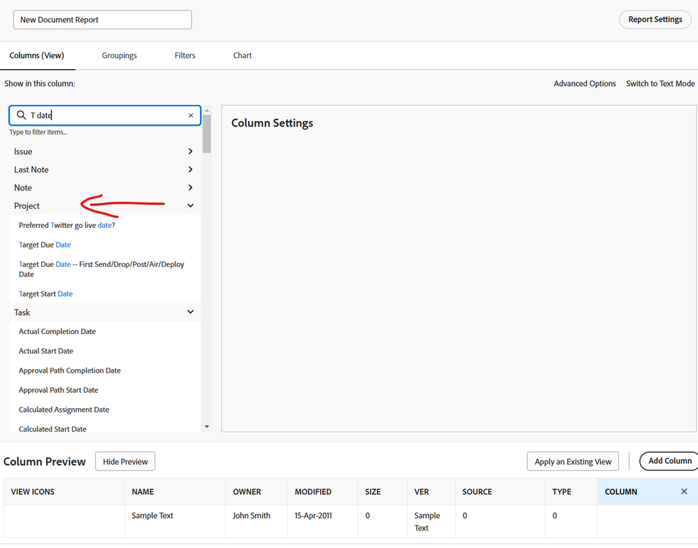

Assuming that the date field is being captured on a project custom form (as your text mode suggests), you shouldn't need to use text mode at all. The Project object and it's data attributes are all available natively from a Document report. In the report builder, simply add a column and search for the "T Date" field, it should appear under the project attributes:
Best Regards,
Rich.
