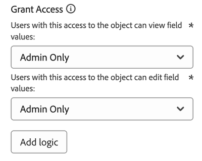

Scenario: We use Workfront's queue feature as our intake form to manage our incoming project requests. Users from outside our organization submit via the queue, and we then turn them into project plans. There are a few fields which are crucial to our project maintenance, but are not fields we wish for those filling out the form to dictate. One example would be a rich text field that we use for "status updates". I am an admin, so created an admin only section with these additional fields, but I am realizing that my users can't see the content of it, nor can they edit the fields. Typically, we go over our workload using the report, and along the way, we add notes into this status update field.
Has anyone found an easy way to integrate necessary custom fields without making them forward facing on the form that does not limit view and edit access to admins only?

yes, we created a section break which is only visible and editable to Admins while submission or post submission of the request.
Right, but what happens when you need non admin users to see and edit the results of these fields?
