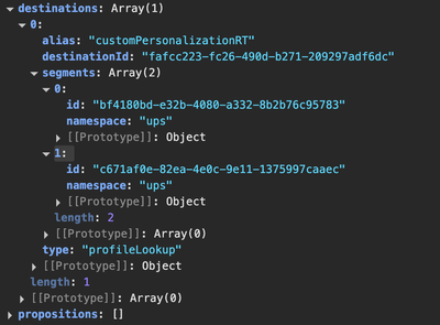

5. Sent a pageView via Web SDK and received this response:
As you can see, there are no profile attributes, which are populated in the Hub profile:

Hello Gigi,
I don't think profile attributes will come via WebSDK.
You need to use Edge Network API calls in an authenticated context.

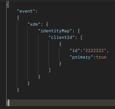

You are totally right. I tried the interaction API call and I got this response:
I was expecting the segmentMembership and the attributes, but I can't see those. Did I forget to toggle anything? Any idea of what could be possible happening?

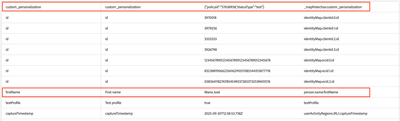

This is the exact problem, with this call, I am getting this response for this call:
No profile attributes. As I show in the screenshot above, this profile does have attributes but I am unable to see them.
We exported first name and custom_personalization attributes to the Custom personalization with attributes destination
@GigiCotruta those profile attributes that you exported to custom pz destination, are they available on the edge in the profile, if you look in the UI?
Yes, they are, the last screenshot I sent are from the Profile Endpoint: https://platform.adobe.io/data/core/ups/access/entities
