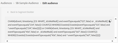

In Adobe Experience Platform Audiences, you can achieve this by creating multiple event conditions and combining them with AND logic as shown below. This ensures the audience includes profiles that have both types of events in their history.

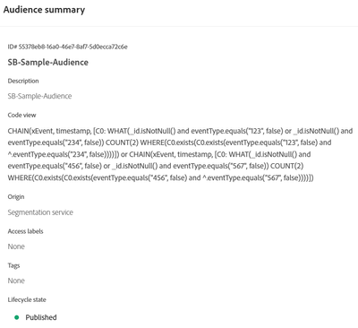

The above code is translated into the below code.

Also in your screenshot you have shared CHAIN(xevent, timestamp....). where in the UI this view is present with heading 'back to segment builder' ?

Hi @pradeep-jaiswal,
We know that complex audience logic is not a possible solution via the UI coding.
But that said, I did get success by creating the audiences using Postman API calls.
I would encourage using different combinations of capturing the script values as defined by the business conditions.
CHAIN(xEvent, timestamp, [C0: WHAT(_id.isNotNull() and eventType.equals("123", false) or _id.isNotNull() and eventType.equals("234", false)) COUNT(2) WHERE(C0.exists(C0.exists(eventType.equals("123", false) and ^.eventType.equals("234", false))))]) or CHAIN(xEvent, timestamp, [C0: WHAT(_id.isNotNull() and eventType.equals("456", false) or _id.isNotNull() and eventType.equals("567", false)) COUNT(2) WHERE(C0.exists(C0.exists(eventType.equals("456", false) and ^.eventType.equals("567", false))))])
