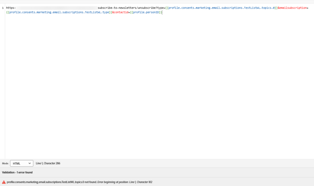

I'm trying to create an unsubscribe link in the email template in AJO. I'm getting a syntax error when trying to access the below field
What would be the proper syntax to access the value in consents.marketing.email.subscriptions.TestListWL.topics.0?
Any feedback is welcome.

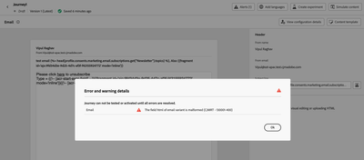

@Winston_2022 I got it to work inside the subject line and also anywhere inside the email body using this formula
{%= head(profile.consents.marketing.email.subscriptions.get("Newsletter").topics)
However, there is something with the URL personalisation piece as it is not allowing me to use the helper functions.
I've even tried using an expression fragment
and it contains the same formula
but when I use it inside the URL, while the UI accepts it, I do get an error on the delivery
Hi, Thank you for the response. It's the same behviour for me. Whilst the syntax appears to be vaild. However the output is an error.
