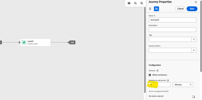

@SkylerQu2 If you want to use the unitary event with repeated profiles. you can control using the below option called allow re-enterence. you can set you specific date. Untill that date, the same profile will not be repeated.  Otherwise, you can uncheck this option. so that same profile will come back again and again.

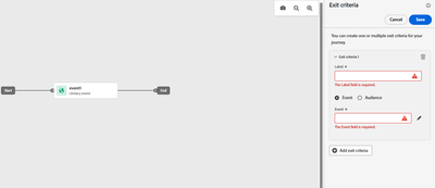

However, your second question is to block the user with event01 with status =a. then you can use the exit criteria as well.

@SkylerQu2 For event, you can remove the allow reenterence checkbox which i mentioned above for your use case. It will allow all the new entrance of the same user again and again
