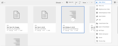

Open in FrameMaker" option exists when a a dita asset is checkmarked

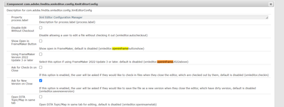

Open in FrameMaker" option exists when a a dita asset is check marked. We don't want that option to be enabled, so we have unchecked this option in configMgr. I have also tried cycling the setting on my instance but it has no impact on the behavior. Do we have any other workaround to get this option disable while marked on dita assets. Including that AEM Guides version has also been updated to 4.6.0.  Thanks in advance!
Below are the screengrabs for your reference:
