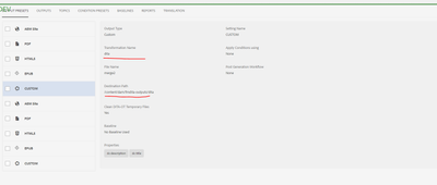

We are trying to generate a "Normalized DITA" output for a map.
The output is getting generated. But it is zipped.

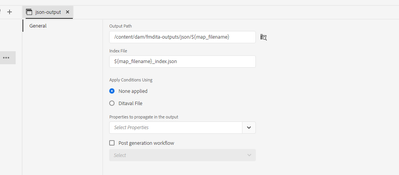

1. How do I generate output in /content/dam/fmdita-outputs/dita that is not zipped. I want the output in a folder, just like how the json output is created.
Is there any configurations in the backend that we can change to enable this?

You can also try using the "DAM Unarchiver Process" but to call it you may have to trigger it from post generation workflow process class.
5 Replies
You can use your custom post-generation workflow( with the process step to unzip), Out of the Box this workflow is not available.
