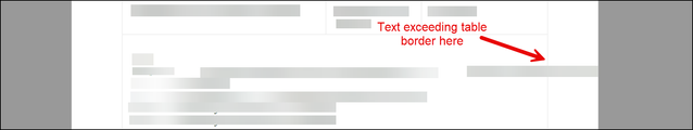

Apparently I misrepresented the problem - apologies! The offending tag is actually the <lines> tag, which is a rather unique one.
It seems like our authors are going to have to rebuild most of these, but I still would like to prevent the tag from being able to exceed the border, if possible! Unfortunately, I had to redact the text on this one, but here is what I'm working with:
and here is the output:
Hopefully this is enough information! The plain AEM PDF output wraps the text normally - is Native PDF able to do the same in this case?

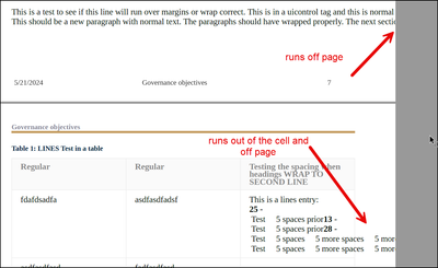

I made a quick example to illustrate the issues I'm seeing.
Here is a segment of a dita topic:
Here is the native PDF output:
Here is a code snippet if it helps!
 <lines>This is a test to see if this line will run over margins or wrap correct. <uicontrol>This is in a uicontrol tag</uicontrol> and this is normal text. <systemoutput>This is system output text</systemoutput> and this is normal text again.
This should be a new paragraph with normal text. The paragraphs should have wrapped properly. The next section is manually spaced</lines>

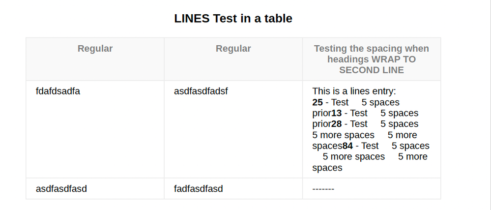

Hi Josh,
I tried the lines and table code shared by you. For me in native PDF it is coming fine. Text is not running out of the cell. It is wrapping correctly.
I think either there is some CSS at play on your end or may be some other content on this page is causing it. Can you try just this table and lines in a new topic and see if it still happens?
Surbhi Maheshwari
Thanks for the response on this one, Surbhi!
I tried this in a new topic and it still displays the same. I'm wondering if maybe the cell or row styles need to have some kind of wrap or margin?
I'm going to look into the different potential styles and see what I can find. If you find/know anything, please let me know!
Thanks!!
Josh
