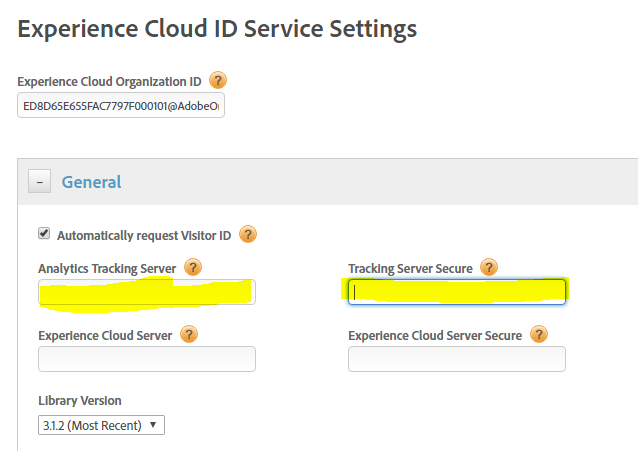

another question.
Do I also keep the tracking server fields in the experience cloud ID service tool blank as well? I assume the tracking servers I created in the adobe analytics tool will be used and pertain to ID service as well?
jantzen_b
jantzen_bAdobe EmployeeAccepted solution
June 29, 2018
You'll need to write custom code to also populate these variables in the visitorAPI.js file. The Analytics tool only populates the values in the AppMeasurement.js file. The Experience Cloud ID Service tool populates the values in the visitorAPi.js file. I believe I've seen some customers use data elements for this purpose but I can't point you to a particular example.
July 2, 2018
So if I use the visitorAPI.js file then I will have to remove the experience cloud ID tool correct?
jantzen_b
July 9, 2018
Yes, if you were to put the VisitorAPI file in the custom section of your Analytics tool, you'd want to remove the ECID tool. Like I said previously, I believe you can accomplish this with data elements and then reference the data element in the ECID tool. this would be the preferred method since it would keep the ECID tool installed.
