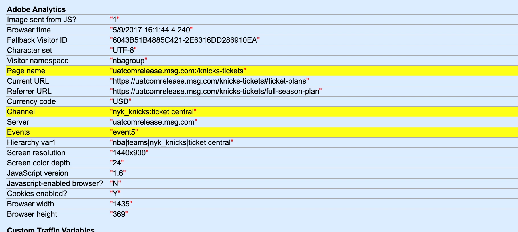

Expected Behavior: Adobe Analytics Page Name should load as [Page URI]:[Page Path]. See screenshot A below.

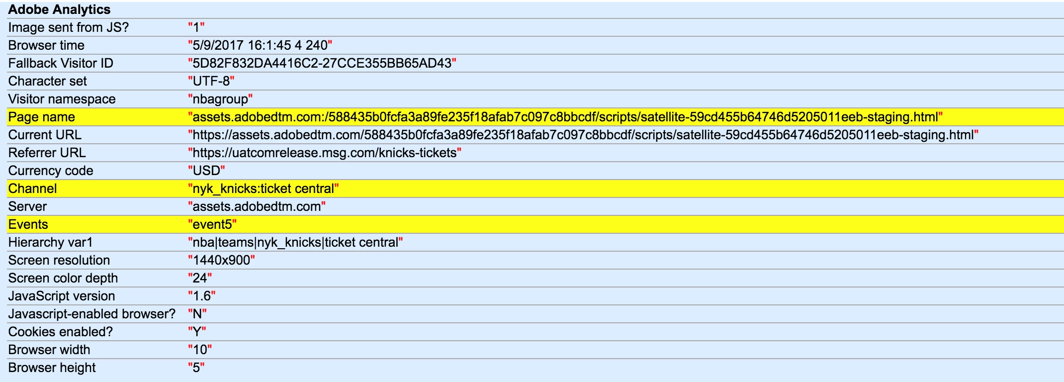

Actual Behavior: Adobe Analytics Page Name is loading as 'assets.adobedtm.com:/588435b0fcfa3a89fe235f18afab7c097c8bbcdf/scripts/satellite-59cd455b64746d5205011eeb-staging.html'. See screenshot B below.

Screenshot A. Page Load Rule (page name correct):
Screenshot B. Event Based Rule (page name incorrect):

After a bit of research, it looks like non-sequential HTML is placed into iframes on event based rules. Since the script is loaded inside an iframe, It doesn't have access to the page and thus it is pulling the pagename of the iframe rather than the page itself.
