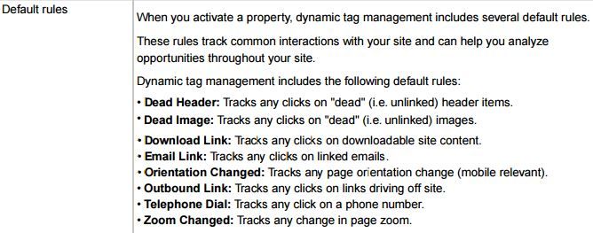

thanks for your help. For anyone else I finally found the descriptions.
Last Question: How is the event based rule for download link different than the Adobe Analytics tool - Link tracking for Download Extensions. Also same question for Outbound Link? Just seems redundant to have both but I assume there was a reason behind it? I just want to ensure we have the most thought-out DTM installation possible.
I believe the event-based rule just gives you a bit more flexibility. For example, If you had downloads for pdf documents and .zip packages but you wanted more than the standard beacon for the pdfs, you could create an event-based rule for the pdfs and customize the beacon.
