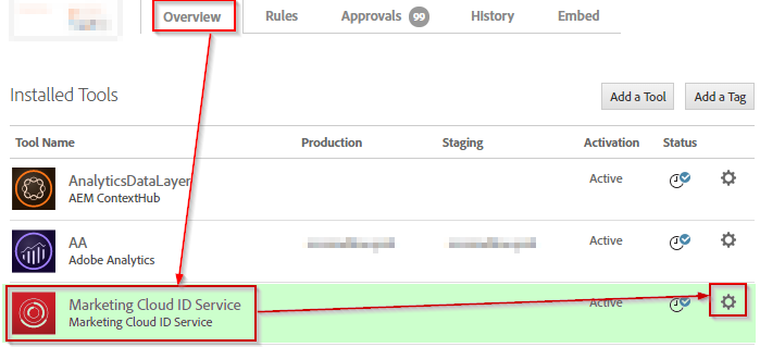

Within DTM, you can set this by navigating to the DTM Property, then
Overview > Marketing Cloud ID Service > Config (gear icon)

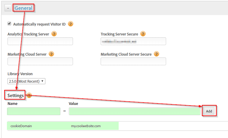

Then, under General > Settings
For Name, add "cookieDomain" (no quotes)
For Value, add the domain you want to be the root domain for the cookie:
