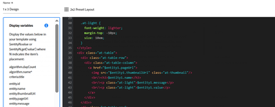

@kandersen  One final clarification , I don't see entity.id in the design template code below . We need to have entity.id in the below design template if we send it to adobe target right?
@kandersen so basically what we need to pass from web sdk into Target is only entity.id and all other product attributes regarding product would be taken from Feeds?
Correct!
