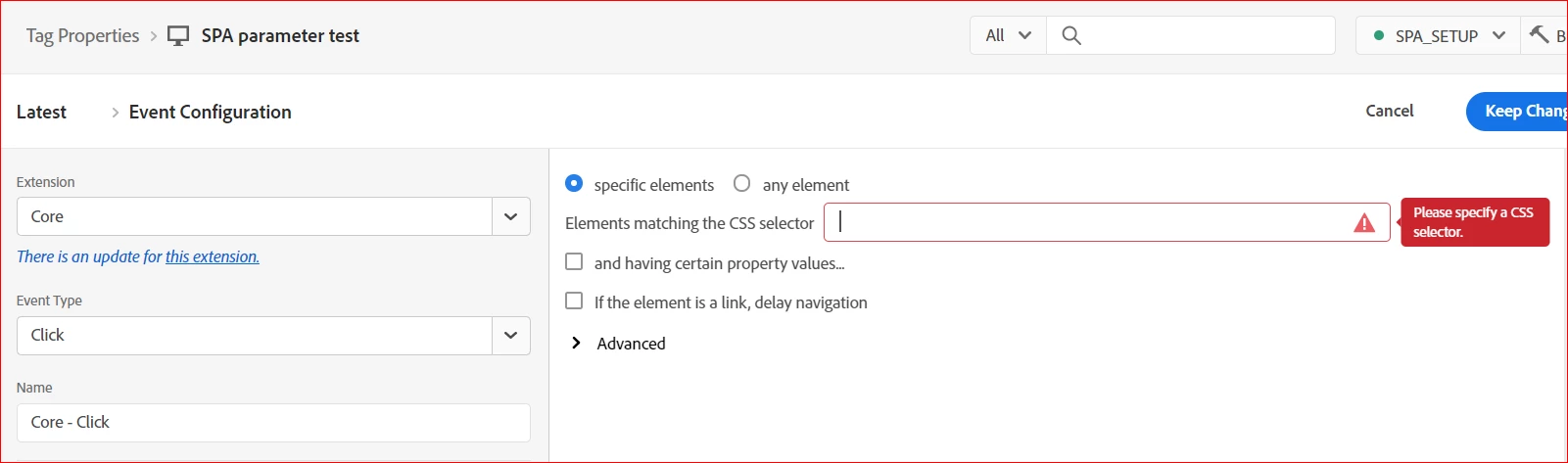

@curtisyoung1987 If you are implementing Target using Launch then there is a simple option of firing triggerView based upon selector ID :
Which may help you in achieving the use case . Else the other option would be to trigger the triggerView function on event/action for a specific element . Was able to find a similar use case discussed over this you tube link : https://www.youtube.com/watch?v=deAUBBDYRWQ .
